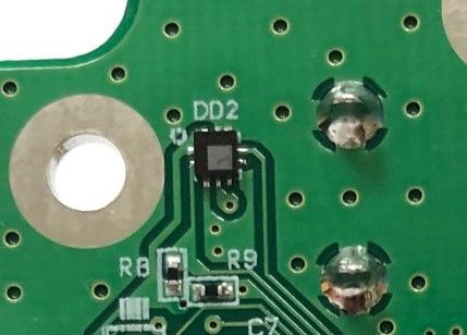

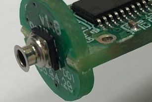

Hi Eleon! Thanks for the help.
All 15 sensors had different spread of values. 0.5 to 5 degrees. All sensors showed a value below the environment. I also have boards with an LPS22 sensor, they measure the temperature correctly, the accuracy is within 1 degree. Temperature conversion program code is the same as for LPS33. All sensors are mounted on PCB and are in the same conditions - in a cardboard box to exclude the influence of air flow. The PCB does not heat up, since the battery powered device operates in a micro-consuming mode (~6μA), the activity is 100mls with a hibernation of 2 minutes. The sensor is remote from the processor.
We plan to use lps33 in the production as a temperature and pressure sensor; we need to solve the problem of the accuracy of the temperature channel.
