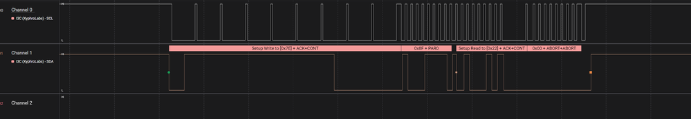

I got the DCR form LPS22HH value is 0x00, but the BCR and TPID value all matched the datasheet except the DCR, and the waveforms as follow:

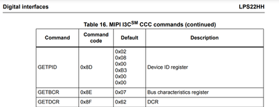

Based on the feature showed in LPS22HH datasheet, the DCR should be 0x62

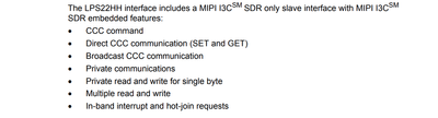

I don't known what's the current I3C version included in LPS22HH sensor. Can anyone help me clarify it?

For the DCR value, you need to align it with the value in the datasheet of the LPS22HH :
There is no need to know the I3C version for this sensor; just follow the commands supported in the datasheet.

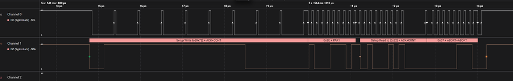

I don't think the decode tool's parameter is incorrect, before GETDCR, the host send GETBCR(0x8E) to get the correct BCR(0x07), the correct waveform as follow:
according the waveform of GETDCR, the GETDCR Byte is 0 after Target Addr ACK
