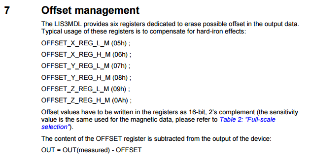

I have gone through the datasheet and app note of LIS3MDL. But i am not able to get how block data update bit work i.e. if someone has set the BDU bit and if I read registers through I2C one by one, then how the ic internally gets idea that all the registers have been read and got the data of same sample?
Also can anyone please elaborate about ODR and its working in LIS3MDL

Please see following chapter from AN4602. The OFFSET is automatically subtracted.
