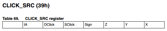

One more thing I would like to tell you that in the datasheet
of
DM00171283 there are no such bit like LIR in the click source register. So, how to use and configure that register for single click detection? Furthermore, my previous query still not be answered. I got the interrupt on single click but I only click one time, interrupt got multiple time. Please provide proper guidance for that.

CLICK_THS ... 1 LSB = full scale/128 (in you case FS = 2g, CLICK_TSH = 0x05 ... 5 * 2g / 128 = 0.078g)
TIME_LIMIT ... 1 LSB = 1/ODR (in you case ODR = 100Hz,
TIME_LIMIT = 0x0D ... 13 * 1 / 100 = 0.13s)
Concerning the behavior you described, I think the X and Sign bits (values 0x09 or 0x01) in CLICK_SRC register are set immediately when the CLICK_THS is reached and the IA bit (value 0x51 or 0x59) is set if the value returns below it within a time window defined by the TIME_LIMIT register. So the IA bit has latency of TIM_LIMIT time.
Basically
you can you can mask other bits in you program and the CLICK using only the IA bit in CLICK_SRC register or use the hardware interrupt signals.

click src 54
x axis is 9y axis is -8z axis is 55******************click src 54x axis is -4y axis is 32z axis is -5******************click src 54x axis is -12y axis is -25z axis is 80******************click src 5ax axis is -7y axis is 66z axis is 127******************click src 54x axis is -2y axis is -24z axis is 81******************click src 5cx axis is -9y axis is -84z axis is 77******************click src 54x axis is 2y axis is 7z axis is 34******************click src 52x axis is 4y axis is 12z axis is -6******************click src 52x axis is -1y axis is 15z axis is -6******************click src 52x axis is 1y axis is 6z axis is 0******************I tap on particular hardware then I got the IA bit set but if I tap around the hardware nothing can happened. So, any specific region around the hardware to tap and got the interrupt?

Hi Miroslav, I have done single click on both method by using hardware interrupt and IA bit masking. it is working fine. However, when I used hardware interrupt then once interrupt is active and I am reading click source register, sometimes it is shown value like below:
click src 2
x axis is -7y axis is -4z axis is 31******************click src 5ax axis is -17y axis is -11z axis is 45******************click src 1x axis is -28y axis is -13z axis is 73******************click src a
x axis is -4y axis is 5z axis is 15******************So, in the case like 0x02,0x01,0x0a IA bit is 0 means that interrupt is not active then how the hardware interrupt is activated? Can I use both condition to check interrupt is active or not? Ex.
