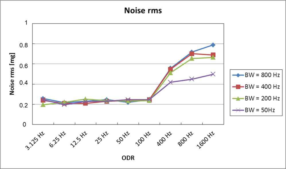

2) on datasheet it's reported typical noise spectral density (150 ug/Hz) at 100 Hz data rate, are there available noise values for different ODR?

hi @mbertoni​ , it's an interesting application, please find below my answers if they can help you:
  1. Unfortunately the matlab model is not publicly available, especially for the internal ASIC blocks
  2. Here below a more complete overview on noise spectral density vs ODR (characterization, not datasheet, data)
