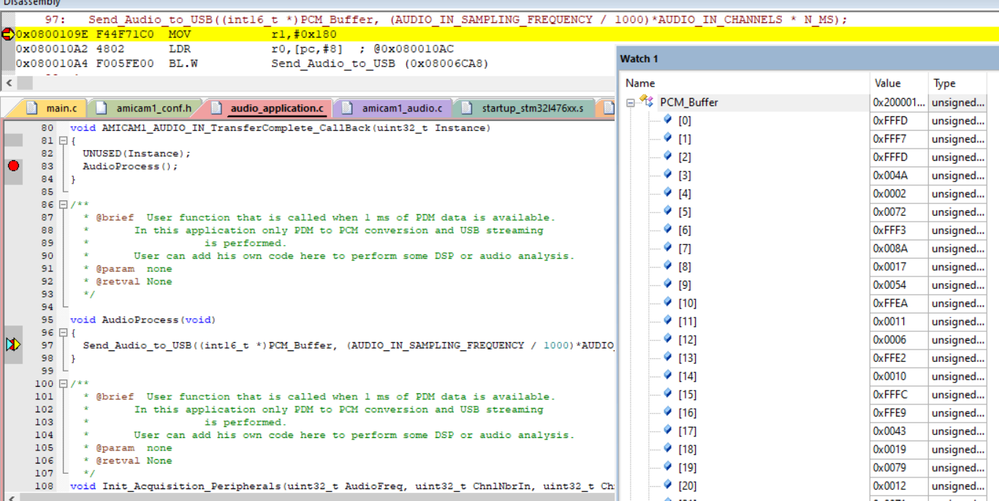

I would like to add FFT algorithms in the "AMICAM1\Microphones_Streaming" based on NUCLEO-STM32L476RG ?
From the document of UM1901, we can get audio data in the callback function(AMICAM1_AUDIO_IN_TransferComplete_CallBack) per 1 msec with 192KHz of samping rate as below.
We hope to save 6 msec of audio data in the PCM_Buffer(192*6=1152, 24 bits of data) from AD1974 for FFT analysis.
When finishing the 1152 bytes of audio data collection, we normalize transfer 24 bits audio data into the range of +/- 1 audio signal for implementing FFT analysis.

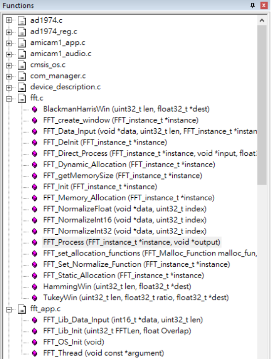

We also can find the fft.c in the library of middle ware as below.

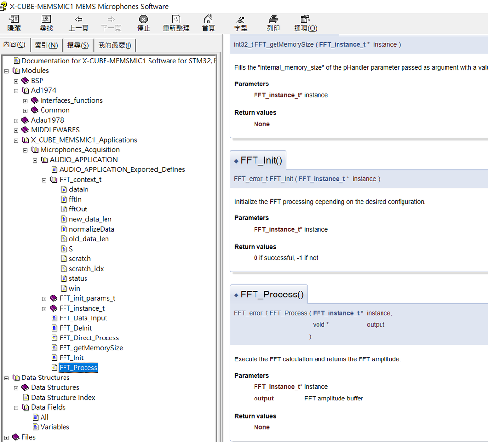

There are some FFT API in a compiled HTML file located in the Documentation folder.
How to implement the 1024 point of FFT algorithms step by step?

Hello @shenghua yang
X-CUBE-MEMSMIC1 already provides an example using FFT.
Is it called UltrasoundFFT and it is placed here: Projects\STM32L476RG-Nucleo\Demonstration\AMICAM1\UltrasoundFFT\.
Start looking at this code example, that is fully working and already provides what you need.
