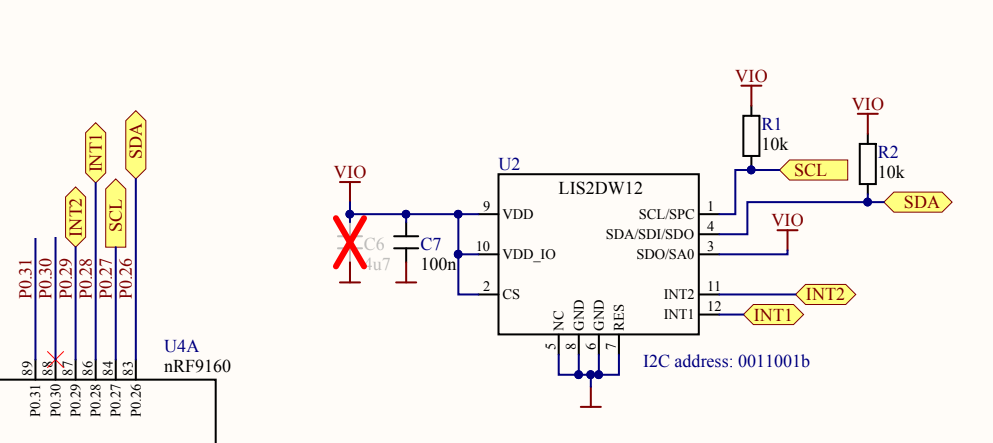

We have STMicroelectonics LIS2DW12 accelerometer on our custom board which has nRF9160 SiP from Nordic Semiconductor and we are using the nRF Connect SDK which runs on Zephyr OS. Here are the LIS2DW12 driver codes of the nRF Connect SDK / Zephyr: https://github.com/nrfconnect/sdk-zephyr/tree/v2.4.99-ncs1/drivers/sensor/lis2dw12
The configuration of the LIS2DW12:
Interrupt pin: INT2
Accel range / full scale: 2G
ODR: 1.6Hz
Power mode: Low Power Mode 1
Low noise: Disabled
Stationary/motion: Enabled
VDD & VDD_IO: 3.0V
Our problem is that our board is consuming a lot of power when we are using the LIS2DW12. If we fully disable LIS2DW12, the consumption is about 20µA and when it's enabled the consumption is around 200uA.

We checked the GPIO configurations of all of the pins connected between LIS2DW12 and nRF9160. On nRF9160 side, SDA and SCL pins have internal pull-ups and also INT1 and INT2 pins have no pull-ups. We tried to change the pull configuration for all of those pins and found that the defaults are the correct ones.
Also, CS pull-up on LIS2DW12 side is connected by default. We tried to disconnect that pull-up and didn't notice any big change there on power consumption.

Hi @APaan.1​ ,
the schematic seems ok to me, except for the 10 uF capacitor between Vdd and GND that you do not have (but it should not give a problem like this).

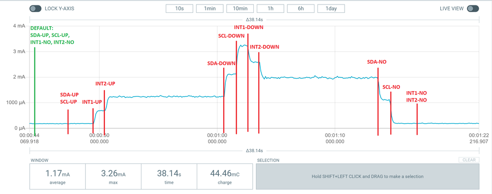

We tried changing the internal pull-ups of the GPIOs on nRF9160. Here you can see the results of the changes:

  • the capacitor should add noise filtering capability on Vdd, it is good practice to use the ones shown in the application hints

  •  on nRF9160 side these pull-ups can delay a little the signal but they should not be able to draw a lot of current
  • the default are the correct ones if you do not add some external hw that changes the situation. the fact that you tried different configuration in your latest message seems to be proof that they are right
  • when using I2C you should always keep CS pin high. an internal pull-up is the reason why disconnecting it does not break I2C communication immediately, but it is not correct to leave it disconnected
