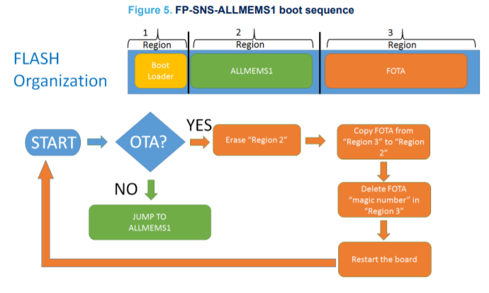

Hi Chiara,
you probably missed the bootloader part: in this case, the code run as well but when you restart the board it doesn't work any more.
This because you are overwriting a section of the code that prevents the board to working.
You can find the details in the user manual UM2059, p.8:
It should be convenient for you to flash the binary file that already contains the Bootloader section: you can find it in the Utilities\BootLoader folder.

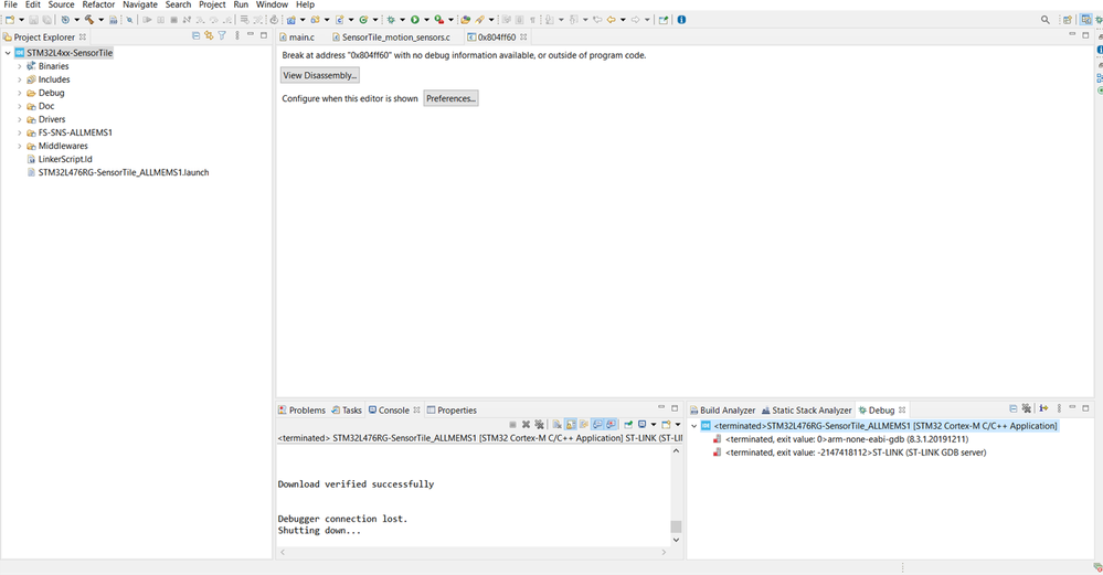

2021-04-30 3:53 AM
yes, I followed the instructions and removed the jumpers from the NUCLEO. My problem is that i can only connect the sensorTile to the bluetooth the first time. after turning it off, the orange led no longer turns on and i can no longer connect. i have to reload the code to make it work.
