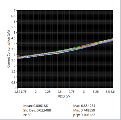

>> Will it be higher when supplied with 3.6V?
The IIS2DLPC will consume a little more at Vdd = 3.6V than at 1.8V, but the main component of this consumption depends on the ODR and the I2C/SPI communication time. In the same ODR condition, the current consumption increase as depicted in the picture below (LPM1 ODR 50Hz with Low noise Disabled):
0693W00000AN90QQAT.pngI cannot disclose the fully device characterization, but this is a general trend that well fits also other operating modes / ODR cases.

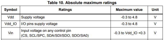

the chips are internally protected from (relatively small) overvoltage shocks, but the first suggestion (that yo can find also in the datasheet, p.27) is to add decoupling capacitor(s) on the Vdd / VddIO lines, at least the 100nF one.
In general, it is recommended that also the AC spikes stays below the Absolute maximum ratings declared in the datasheet:
If so, the device accuracy will not be affected.

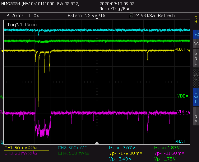

I am working on a battery powered sensor device, that also has a bluetooth low energy radio on board. The purpose of the accelerometer is to generate a wake-up-interrupt when a significant movement is detected. The interrupt will then trigger a measurement.
The BLE radio will always be on, and in regular time intervals, when the transmitter is working at full power, the battery voltage will drop by approximately 200mV. A typical voltage waveform looks like this:
0693W00000AMF05QAH.pngThe yellow curve is the AC coupled battery voltage, the purple curve shows the 1.8V I/O voltage of the CPU (also AC coupled).
In theory it would be possible to supply the accelerometer directly from the battery, since the operating range goes up to 3.6V. But i am afraid the sensor might falsely detect a wakeup event during periods of high radio Tx power, when voltage is not stable enough.
The 1.8V I/O voltage is also not very clean, as you can see.
Thats why i would like to know if there are any recommended limits for such fast changing AC components in the supply voltage. I guess this is a very common problem when you have fast changing loads on a supply, so hopefully you can help me there.

Another thing just came to my mind: maybe it will not save us any current at all when we supply the sensor without an LDO from the battery. In the data sheet the current consumption values for the IIS2DLPC are given for a supply voltage of 1.8V. Will it be higher when supplied with 3.6V? If yes, then the extra current consumption could be lower when we supply the sensor from a 1.8V LDO with a low Iq.

Hi Eleon,
thank you, that information helps me a lot. The increase of current consuption between Vdd=1.8V and Vdd=3.6V is not that big, and due to constrained PCB size we can now save the space for an extra LDO.
