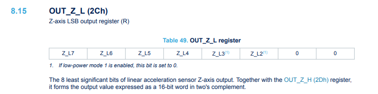

Register 2Ch is certainly not correct since from datasheet the last two bits of the register should be '0':
_legacyfs_online_stmicro_images_0693W00000bkwnQQAQ.pngI also have some doubts about the outputs of the OUT_Y registers, how did you do the conversion from LSB to mg?
Thanks

Thank you for the reply. Can you let me know how to correct register 2Ch

Hi @ggowd.1​ ,
Initially I was seeing different values of the registers, the answer had not updated after your change.
Can you confirm that you set FS=4g? Your data seems correct but if you set FS=2g and HP mode.
Also, your calculation is wrong, you should multiply the LSB value by the sensitivity value. If the sensor is in static position on the Z axis you should read about 1000mg.

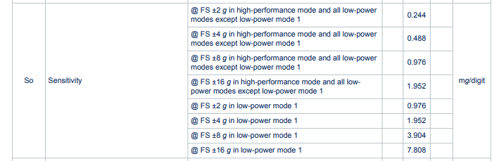

Where did you find this sensitivity value (32768.0)?
Federica Bossi
To obtain a value about 1000mg on Z axis when the sensor is in a steady state you should multiply your output in LSB by sensitivity reported in Datasheet corresponding to your full scale and power mode:
_legacyfs_online_stmicro_images_0693W00000bl8NPQAY.pngLet me know if you read something near 1000mg.
