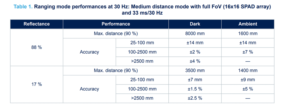

Thank you very much for explaining the significance of the histogram feature in reaching the maximum distance. Therefore, if I were to implement the VL53L1CB API, I should be able to read measurements up to 8m at 30 Hz (33 ms timing budget) as specified on Table 1 of the Ranging Mode Performances document for the VL53L1? Also is it a typo that it says that it will read the maximum distance under Medium distance mode? Because in other documentation it says that the Long distance mode is necessary to obtain the maximum range.
