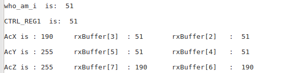

Hi, Thanks for your quick reply. I tried reading the OFh Register But as you can see it's returning 51(integer).

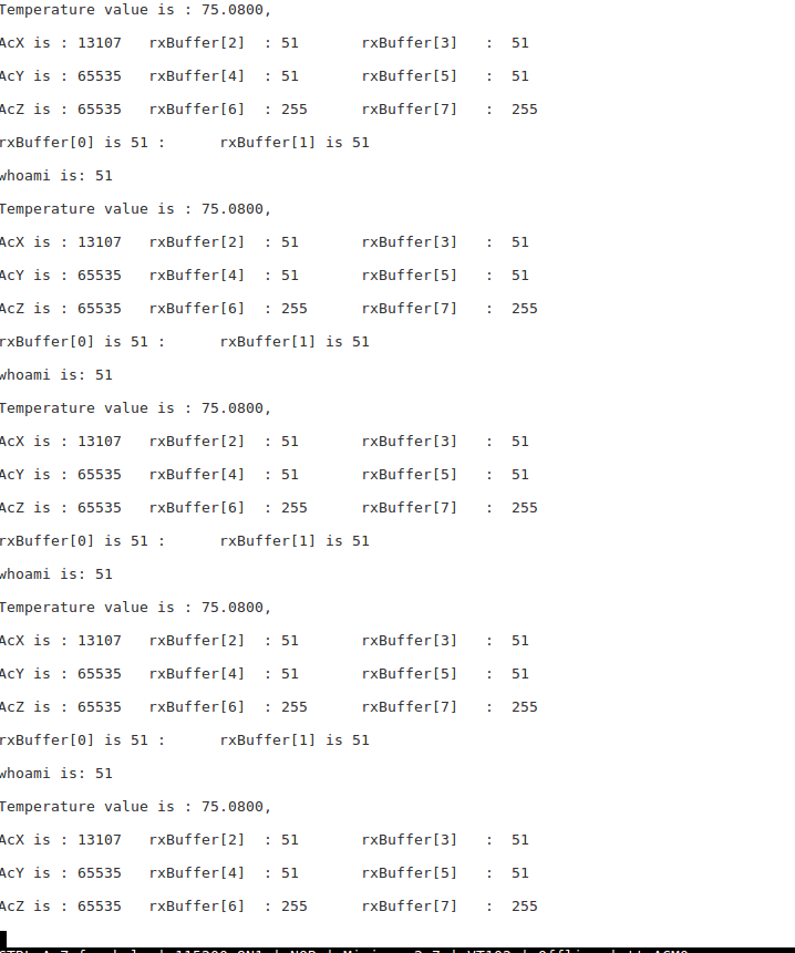

and with this code:
txBuffer[0]=0x0F;
i2cTransaction.slaveAddress = 0x19;
i2cTransaction.writeBuf = NULL;
i2cTransaction.writeCount = 0;
i2cTransaction.readBuf = rxBuffer;
i2cTransaction.readCount = 2;
status = I2C_transfer(i2c, &i2cTransaction);
if (!status) {
// Unsuccessful I2C transfer
txBuffer[1] = 0x0C;
//txBuffer[1] = 0;
i2cTransaction.writeBuf = txBuffer;
i2cTransaction.writeCount =1;
while (status == false) {
Display_printf(display, 0, 0, "Unsucessful I2C Read");
sleep(2);
//txBuffer[0] = 0x3B;
txBuffer[2] = 0x28;
i2cTransaction.readCount = 6;
sleep(2);
/* Take 20 samples and print them out onto the console */
for (sample = 0; sample < 1231150; sample++) {
if (I2C_transfer(i2c, &i2cTransaction)) {
/* Extract degrees C from the received data; see TMP116 datasheet */
//temperature = (rxBuffer[0] << 8) | (rxBuffer[1]);
//temperature *= 0.0078125;
whoami= (rxBuffer[0]) | (rxBuffer[1]);
TMP = (rxBuffer[2] <<8) | (rxBuffer[3]);
AcX = (rxBuffer[4] <<8) | (rxBuffer[5]);
AcY = (rxBuffer[6] <<8) | (rxBuffer[7]);
AcZ = (rxBuffer[8] <<8) | (rxBuffer[9]);
Temperature =TMP/340.00+36.53

Yea I have set CTRL_REG1(20h) to 57h i.e. 0101 (100Hz ODR) but still Accel x,y,z, values never changes.
Code:

Display_printf(display, 0, 0,"who_am_i is: %d \n", who_am_i);
Display_printf(display, 0, 0,"CTRL_REG1 is: %d \n", CTRL_REG1);
Display_printf(display, 0, 0, "AcX is : %d \t rxBuffer[3] : %d \t rxBuffer[2] : %d \n", AcX,rxBuffer[2], rxBuffer[3]);
Display_printf(display, 0, 0, "AcY is : %d \t rxBuffer[5] : %d \t rxBuffer[4] : %d \n", AcY,rxBuffer[4], rxBuffer[5]);
Display_printf(display, 0, 0, "AcZ is : %d \t rxBuffer[7] : %d \t rxBuffer[6] : %d \n", AcZ,rxBuffer[6], rxBuffer[7]);
