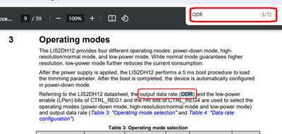

That's an Application Note - not the Datasheet.
The Datasheet is https://www.st.com/resource/en/datasheet/lis2dh12.pdf
The Datasheet never once gives the meaning of the "ODR" abbreviation.
The Application Note uses it four times before finally mentioning the meaning on page 9 - and that's just in passing:
Even that's not very clear: it could be bits per second, bytes per second, etc, ...

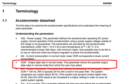

When I first started with this kind of thing, I remember being uncertain whether it was the rate of (x,y,z) triplets, or just the total rate of data (bytes/s).
Addendum
There's also Application Note AN4508, "Parameters and calibration of a low-g 3-axis accelerometer"
It has a 'Terminology' section, but still doesn't make it clear:
