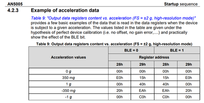

LIS2DH12 accelerometer. AN5005 datasheet. How is the data in the table in column 1 (Acceleration values) calculated? (See Figure 1). I read the calculation process in the datasheet above, but did not understand it. (See Figure 2).

I did not understand how the values in 28h and 29h registers are formed (see Figure 1). And how the first column of the table (Acceleration values) is formed from the values in the registers.

3. Left Justified
The 28h and 29h pair of registers holds 16 bits, but the acceleration values are (at most) only 12 bits - so there are four "spare" bits.
"Left Justified" means that 12 left-most bits are used, and the 4 right-most bits are the spares.
Therefore the numbers become:
+350 (decimal) --> 0001 0101 1110 0000 (binary) = 0x15E0;
-350 (decimal) --> 1110 1010 0010 0000 (binary) = 0xEA20.
Which are the values you see in the table:
2024-02-07 6:33 AM
Hi @MykolaLevun ,
The Numbers need to be read as:
0 --> 0x0000 --> 0
350mg --> 0x15e0 --> 5600
1g --> 0x4000 --> 16384
-350mg --> 0xea20 --> 59936 = 2^16 - 5600
-1g --> 0xc000 --> 49152 = 2^16 - 16384
Two complement means that to find the magnitude of a negative number, you need to do two's complement once more, or do 2^16 - number as shown above.

Thank you, yours and the @Andrew Neil's answers were useful and there was an understanding.
