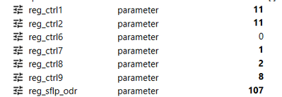

The current configuration I have is this, values are decimal.

Also I suppose that I still can use the configuration that I'm applying (current config is the picture on the previous message) regarding register CTRL 6, 7, 8, 9  and disable SFLP.
Regarding register configuration I'm not sure if the configuration I'm using is the better configuration or not, I'm not completely sure to understand the real contribution or affect of each configurable parameter. I've tested several combination of register configuration and I'm using the one which give me better results . Also do you have more information or explanation about the contribution of each configurable parameter?
