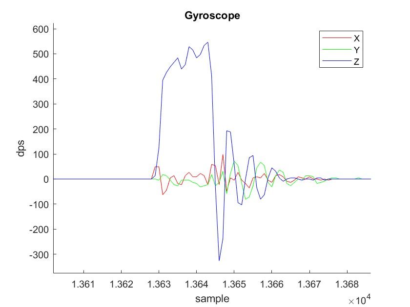

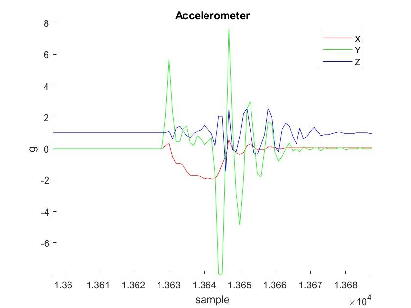

Just to add on,
I decided to put the device on a motorized platform so that any human movements are negated. Here is a link to the setup (video). I have uploaded the accelerometer and gyroscope data during period of movement for your reference. Does the output make sense to you? Just want to be sure the sensor is working properly.
Accelerometer Output:
Gyroscope Output:
Thank you,
Imran

Hi @IKalhoro ,
According to DS the typical value for gyro noise is 75 mdps, while the typical values of accelerometer noise is 1.8mg @FS=2g.
looking quickly at your video and your data, these seem consistent.
