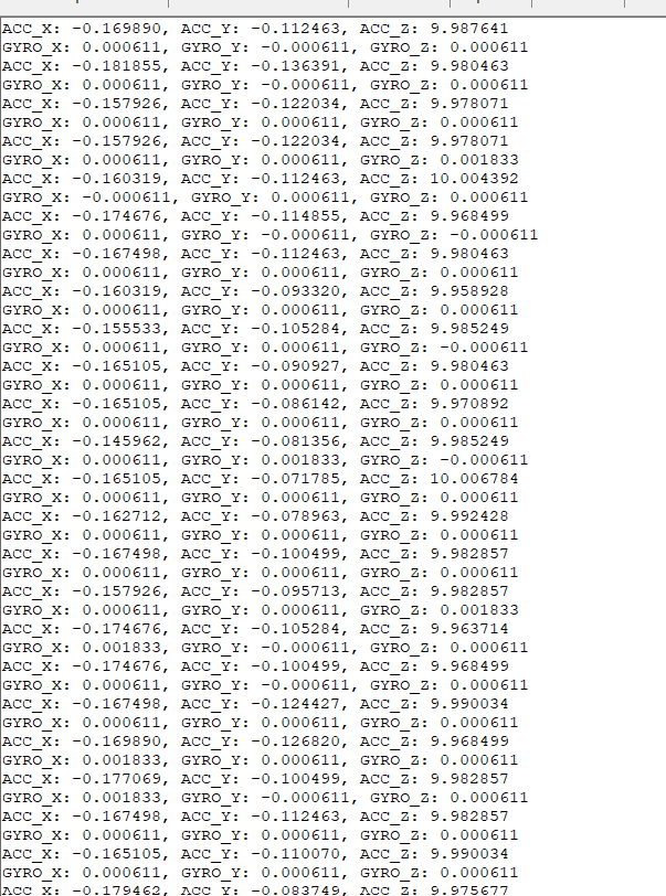

Without doing any calibration, I set, the gyro is 1000 dps and accel is 8G and the sampling frequency of both to 104 Hz. The values I measured under these conditions are as in the picture. The IMU sensor's position is constant and perpendicular to the Z axis.
_legacyfs_online_stmicro_images_0693W00000bjwptQAA.pngThank for helping.

I confirm you that the sensors are already calibrated by factory.
However, for some applications, it could be suggested to subtract residual offset (for accelerometer) and ZRL (for gyro). To do so, acquire some samples for each axis and calculate the average. Then substract this value to the acquisitions.

I'm asking you to confirm me, is it enough for me to take the average for each axis and subtract from the new value for both the gyro and the accelerometer? For the gyro this is true but for the accelerometer I'm asking because I'm not sure. Is it enough for me to calibrate by averaging in both (gyro and accelerometer) and subtracting from the new value? Yes, it is.
Could you explain a little more what you mean by some applications? I will use this IMU for motion estimation, is it necessary for this application? do i have to? It depends on how you implemented the algorithm. You can try not doing the calibration and in case add it later.
