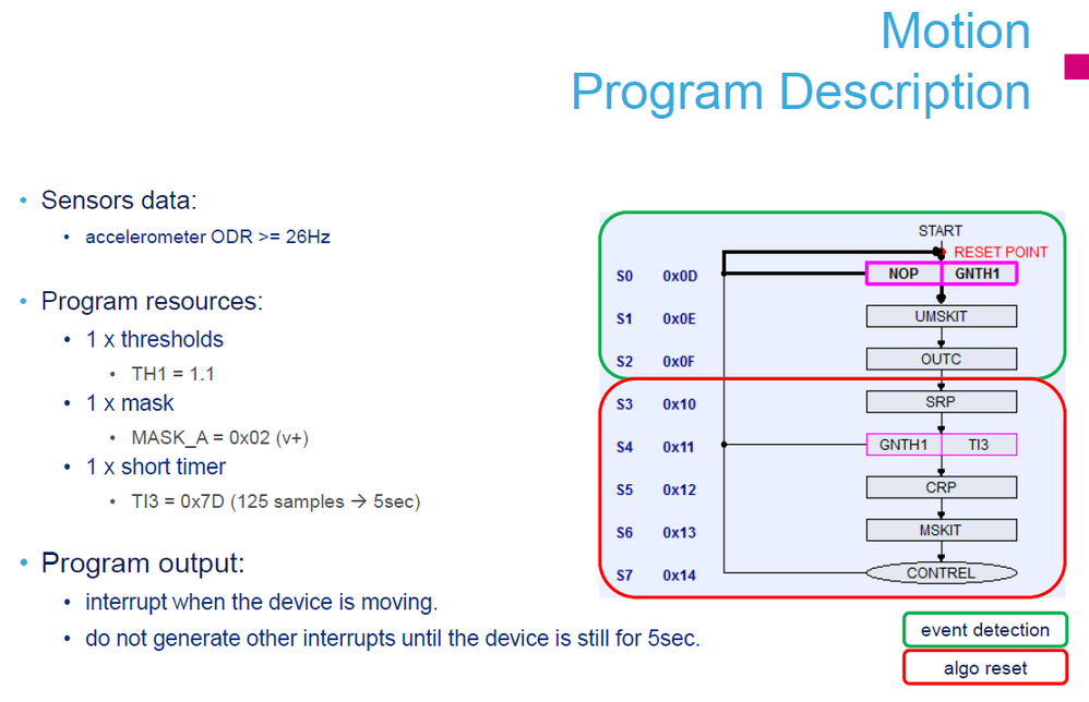

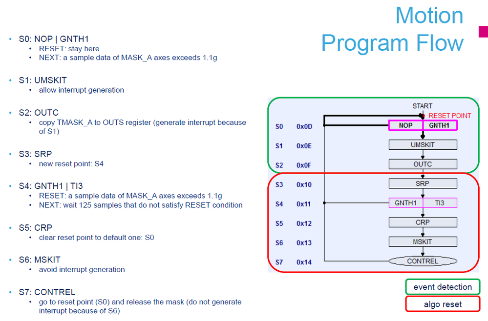

Can I use motion/station event with fsm to detect moving of a car ?
In this link can I use (lsm6so_prg_motion) values to detect motion ?
2021-04-01 12:41 AM
I believe so: this is a generic flow for motion detection.
You might have to fine-tune the threshold and the timings for taking into account a car motion instead of a person motion, but should work.
Here below I share you some more details on this FSM algorithm:
-Eleon
