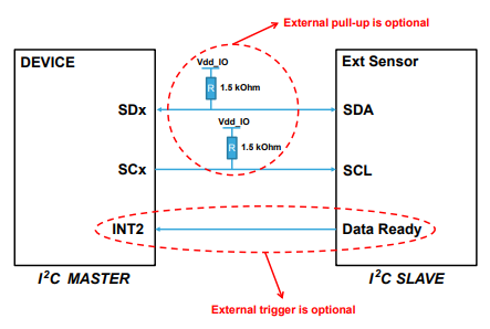

Hi @jb , you can feed of course the device with the external SPI clock, but unfortunately is not possible to change the internal clock. Are you referring to a jitter issue in the FIFO data reading? Did you set the BDU bit in CTRL3_C (12h) and/or the STOP_ON_FTH bit in FIFO_CTRL4 (09h), to assure that the single data available is ok and the FIFO is full before reading it? Alternatively, you could try to synchronize better two different LSM6DSL using the Mode 2 - Sensor hub mode feature described in the AN5040 p.58: in sensor hub mode (Mode 2) you can connect up to 4 external sensors to the I2C master interface of the master LSM6DSL device and you can trigger the slave sensors acquisition with the INT2 pin. Regards
