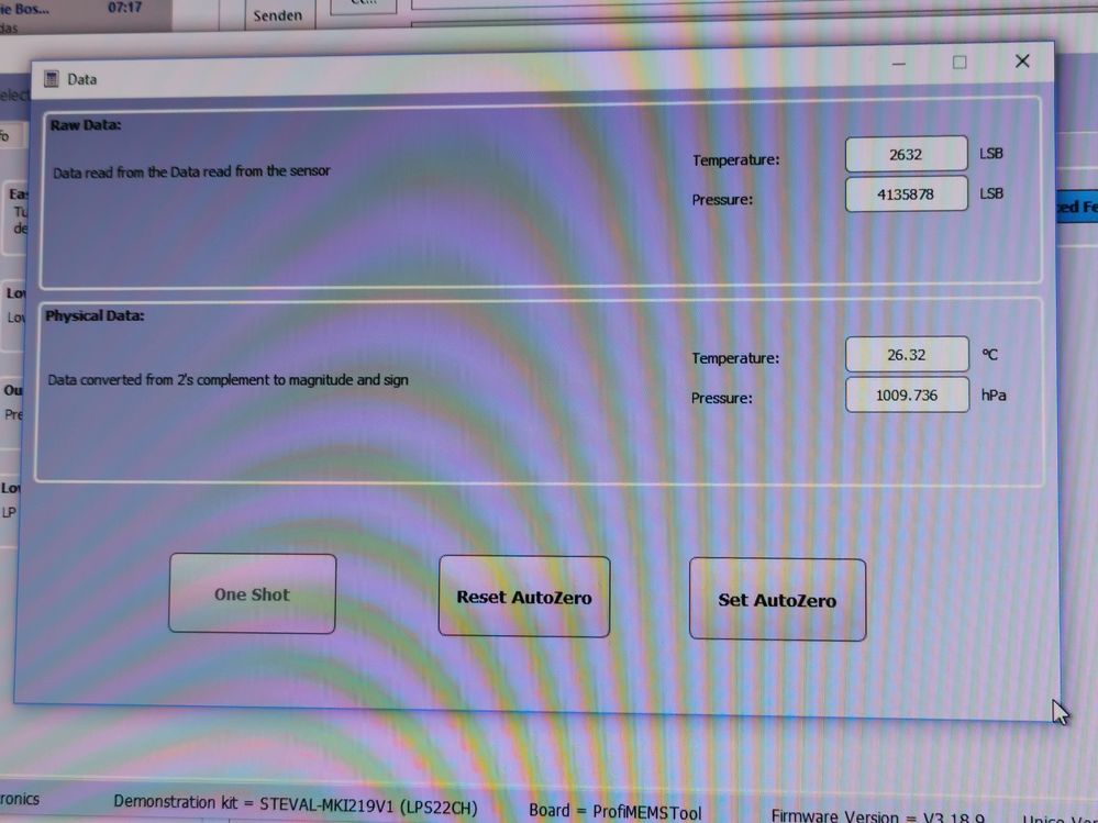

At the weekend I got a STEVAL-MKI109V3 board on loan with which I can use the same STEVAL-MKI219V1 sensor.
Starting the UNICO GUI software is successful and the sensor is also correctly recognized.
The plot shows the temperature and pressure.
The temperature changes as soon as I put my finger on the sensor.
Now to the negative pressure: I started the same experiment as I did before as shown in the two pictures.
This time to confirm that the system is tight, I hung another vacuum measuring device in the line.
The negative pressure on the second measuring device is displayed correctly.
Unfortunately not from the lps22ch?
The negative pressure value only changes when the temperature changes.

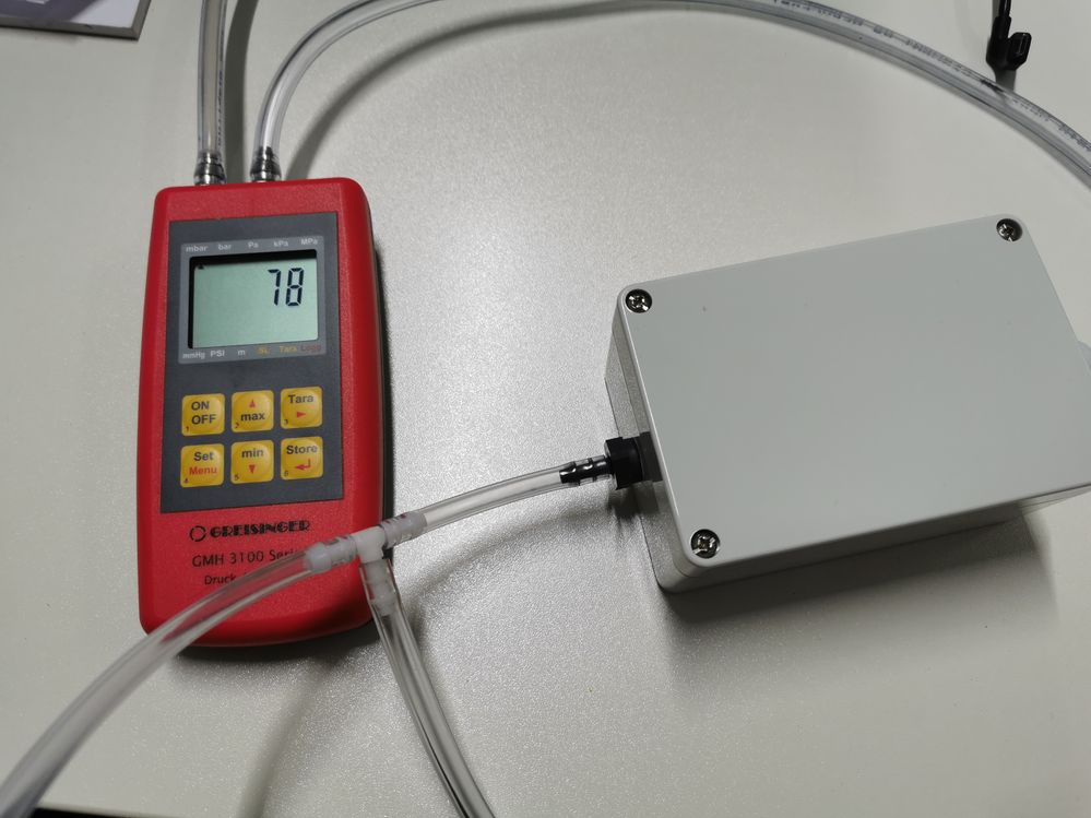

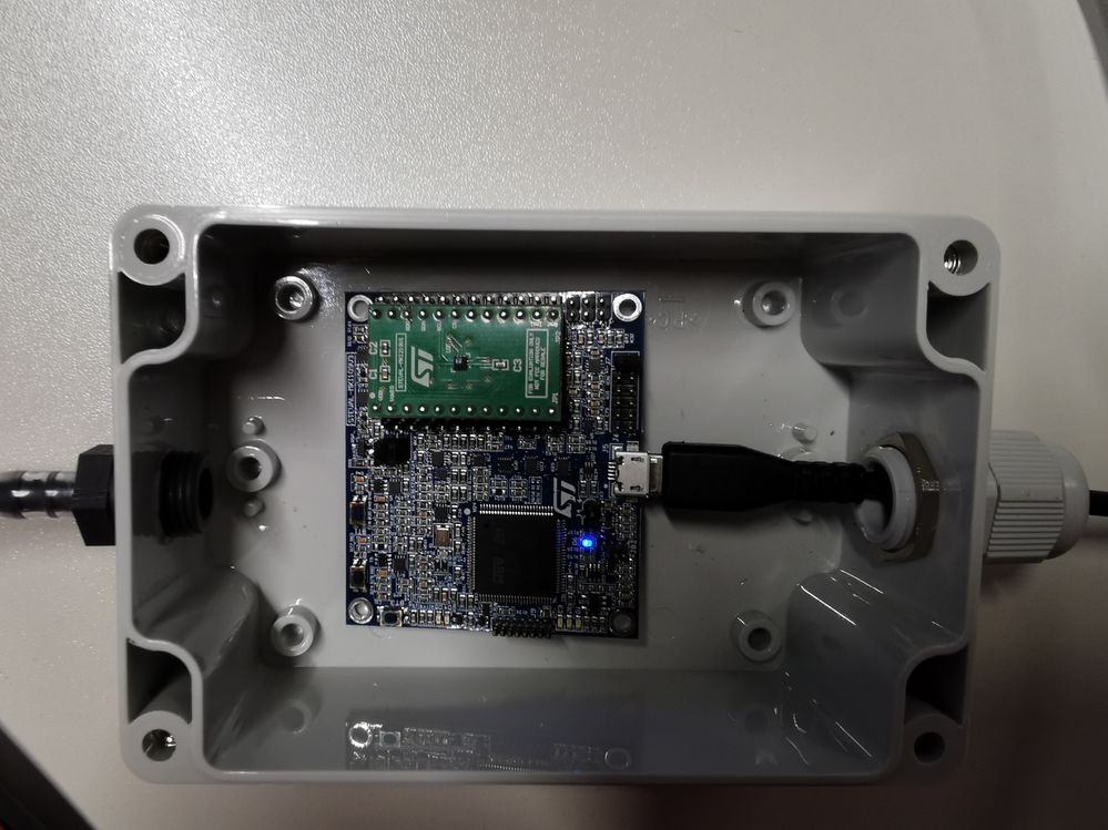

To confirm that my application is tight, I installed the board with the sensor in a separate housing.
Unfortunately, the value does not change in the Unico GUI.
The GREISINGER measuring device shows a negative pressure of approx. 78 mbar in the housing.
Thus the value in the Unico GUI should show approx. 931 hPa.0693W00000DlYyaQAF.jpg0693W00000DlYyVQAV.jpg0693W00000DlYyQQAV.jpg

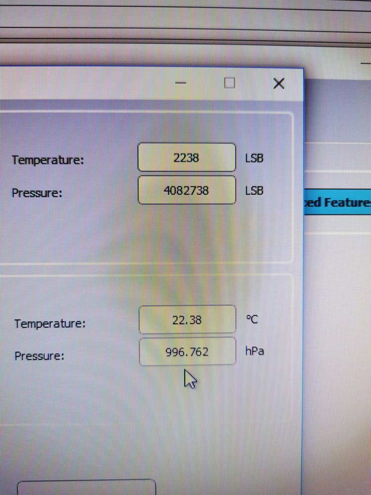

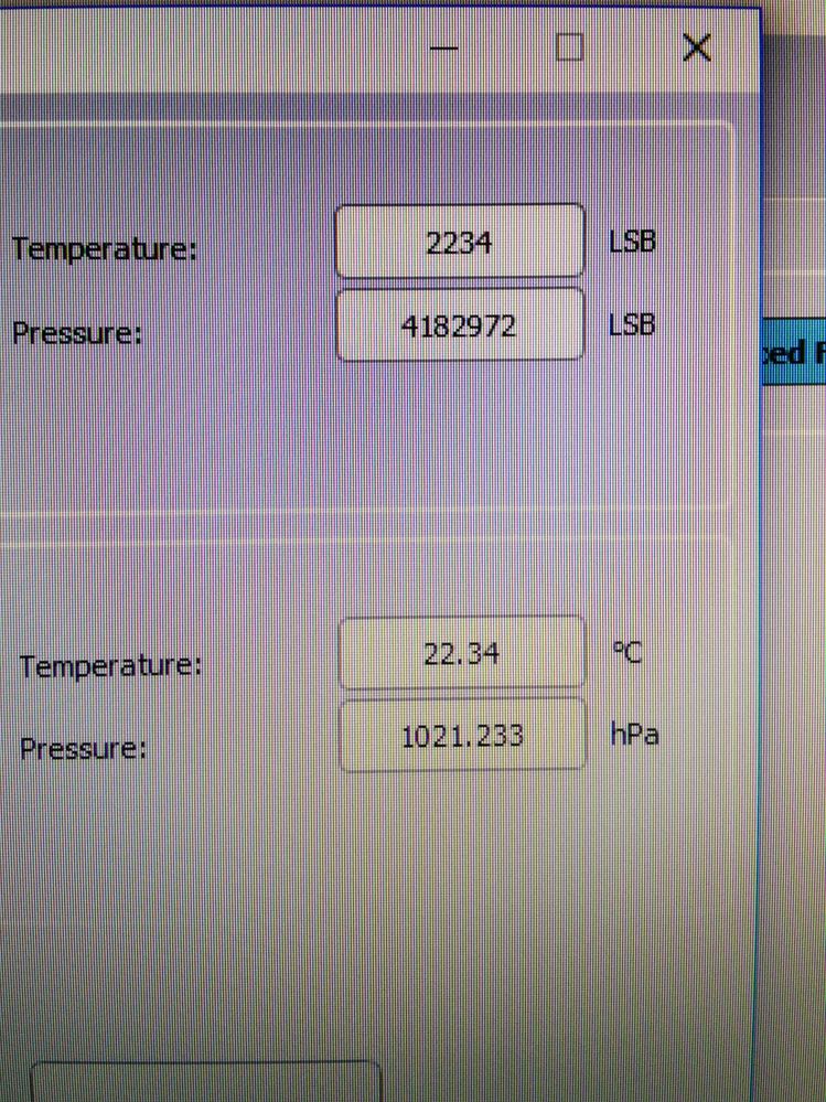

I have two of the sensors.
Which also amazes me that the two sensors will display different ones when idling.
one sensor shows 1021 hPa absolute when idling and the second sensor 996 hPa.
I don't understand why the values show such a large difference.
But nonetheless, when I create a negative pressure, both show no change.0693W00000DlqGgQAJ.jpg0693W00000DlqGbQAJ.jpg

I was made aware that maybe the ventilation openings are blocked, to be honest, when I looked under a microscope, I did not see any openings in the chip. Are there any at all.
