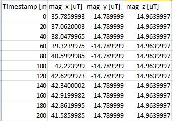

While trying to calibrate the magnetometer, upon successive failures, I noticed that the values that were read for the Y and Z axes are successively repeated until a different value is read (as can be seen below). It appears that there's some kind of great threshold for a new value to be stored in the register.

I have attached a .csv file that serves as a datalog of the several readings while rotating the LSM9DS1 with the motion described in section 2.2.5 of the UM2192.

From your acquisition data, it looks as the Y and Z axis were blocked, or at least not refreshed.
