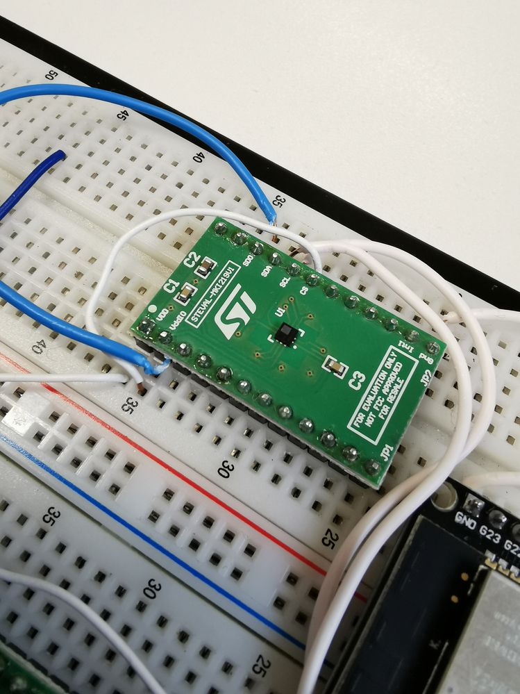

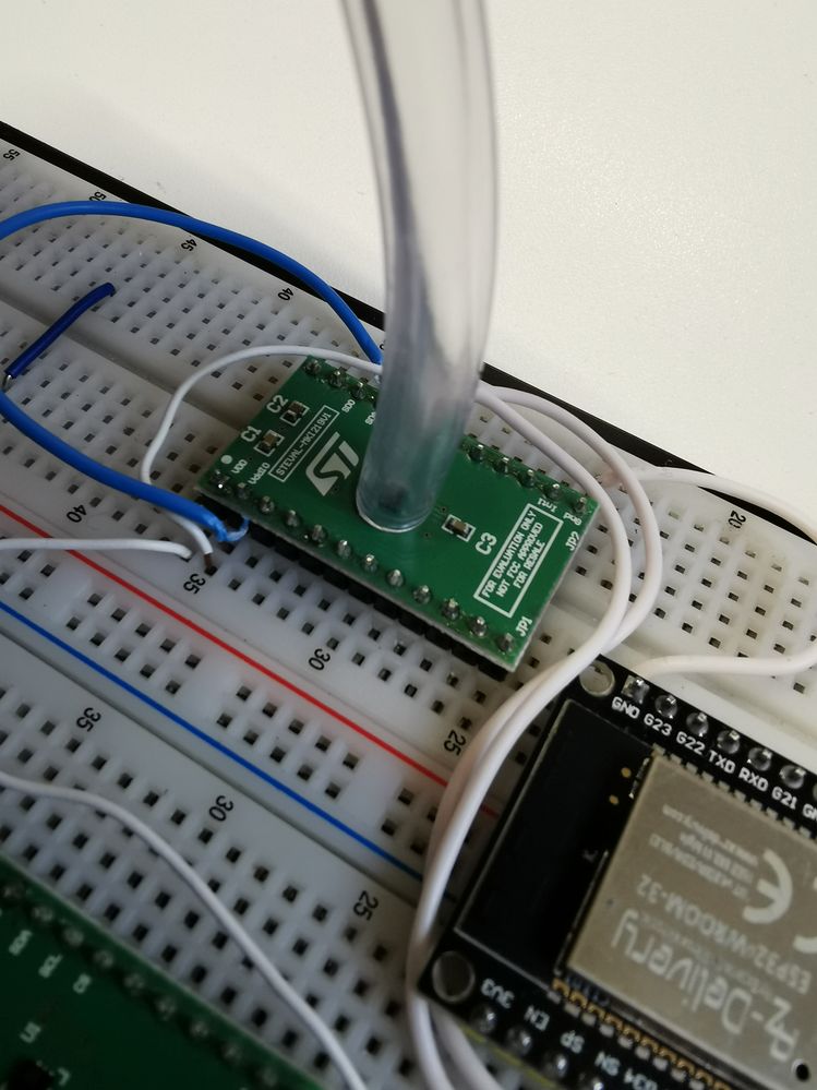

The structure is provisional. I press the hose against the circuit board and suck on the hose. I feel that the negative pressure is not escaping.0693W00000DqBi0QAF.jpg0693W00000DqBhWQAV.jpg
Hi @AMaro.2​ ,
are you sure you are sealing well the tube on the adapter?
If not, the air pressure will be almost equal to the ambient one.
You might try to seal the tube on the adapter with hot glue, if you can.
-Eleon
I'm actually pretty sure that the pressure of the hose against the plate is tight.
For a simple query I only have to configure the CTRL_REG1 (10h) register to at least 1 hz, i.e. write a 0x10h in the register. And then the query of the three registers PRESS_OUT_H (2Ah), PRESS_OUT_L (29h) and PRESS_OUT_XL (28h) and divide by 4096?
I mean if I check the WhoAmI register and the temperature and the values are correct, I don't know what I'm doing wrong with the print?
