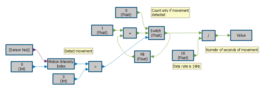

I would like to be able to create a timer that counts time elapsed during an activity and resets when the activity stops. Any suggestions on how to do this.

Hi @J-Damron ,
can you please check if Miroslav's useful suggestion is matching your application purpose?

Thank you Miroslav,
Your example is exactly what I needed to help me move forward with my project.
