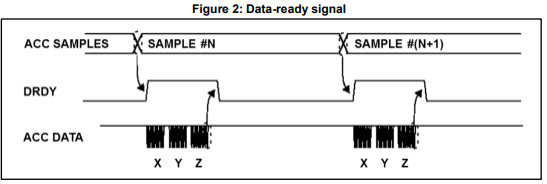

Please consider also this description you can find in AN4662 application note, p.14:
The data-ready signal rises to 1 when a new set of acceleration data has been generated and is available to be read. The interrupt is reset when the higher part of the data of all the enabled channels has been read (29h, 2Bh, 2Dh). If the output registers have not been read for a long time, a dummy read must be performed in order to clear the data-ready signal.

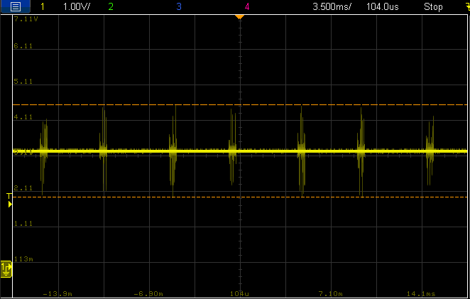

0693W000003QfMqQAK.pngHello,
on scope i can see something on the interrupt pin.
But it is no clear signal.
After each SPI communication i do a pause.
The longer the pause the longer the spaces on the scope.

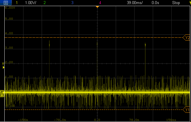

 Here i can see that the measure is done every 100ms (10 Hz).
INT1 does work. But the signal is very ugli for low signal.
