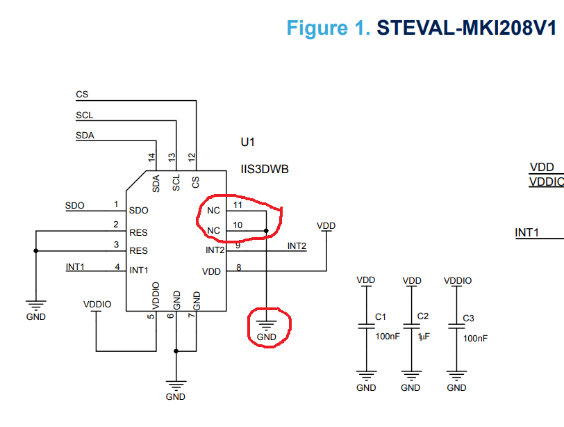

The accelerometer is horizontal, in the Z axis 1g and I have about 500 mg in the X axis. I have 3 pieces of accelerometers and in similar positions I have different readings from the X axis.
Temperature reads correctly.
I found a certain inaccuracy:
in the documentation:
in the evaluation board:
could this be the cause of the error? I also have an evaluation board and it works ok.

2020-11-18 1:31 AM
Hi @PSzym.3 ,
your finding (the fact that the datasheet and the adapter schematic are showing different configurations for those pins) is correct, but there is no difference/effect of this on the data-out of the IIS3DWB devices.
I have some questions to try a better understanding of the issue: how many samples do you have tested? And are all these samples doing the same thing? Did you test all the samples soldered on the adapter? And is this "just" an offset of 500mg or is a high noise (for example a data that is jumping from 0mg to 500mg in a steady state condition, i.e. with the z axis pointing upwards and, possibly, with no tilts along x and y axis)?

2020-11-25 7:08 AM
Hi @PSzym.3 ,
thank you for coming back for this confirmation (and for the detailed explanation of the problem, in the comment before).
Data seemed a little weird indeed...
>> Maybe the chips were overheated during soldering.
This might be the case... you can check it comparing your soldering process with the datasheet p.49 info or with the technical note TN1198.
