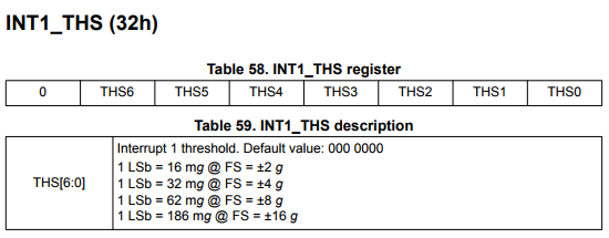

Here is description of the interrupt threshold, the value is related to used Full Scale.

Thank you. That means if I set the threshold to 0x08 for +-2g full scale than 16*8=128mg value is set for threshold value. Am I right or wrong?
2018-01-29 2:16 AM
Yes, that is correct.
