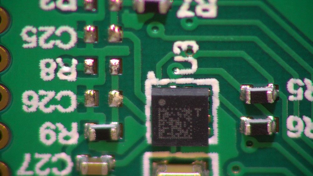

Attached is an image of the mounted sensor were the marking is a dot, a datamatrix and a 'T'.

The schematics is OK, but I compered your schematic, the image of your board and pin out in datasheet, I see they are not aligned.
I added the pin description in your picture and I see for example the CS and SDO pins are connect to your interrupt circuit. So most of the pins have wrong connection.
Can you please double check your sensor footprint and layout of the boards?

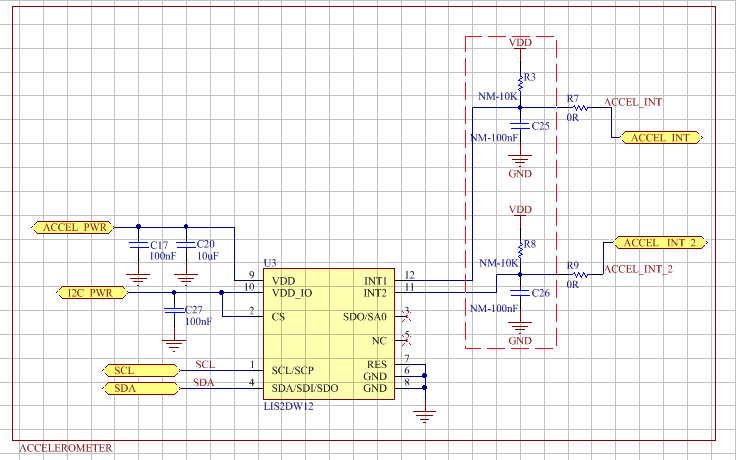

Here is the sch part for the accel.
SCL and SDA lines have an external 10k pull up resistor to i2c_pwr.
VDD and VDD_IO are 3V voltages.
If there is anything wrong or there is something to test or take into account let us know. thanks!
Posted on January 29, 2018 at 10:14

You are right, the datasheet specifies the pinout seen from the bottom and we didnt realize it.
We have flipped the component and mounted it properly to check that with right connection the sensor works.
