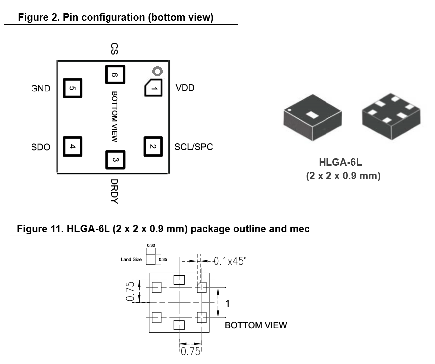

Is the pin out diagram on page 6 which is labeled ''bottom view'' actually a view from the top?

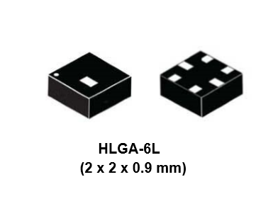

VCC is in the upper left corner (pin 1). The top side view shows the pin 1 ''dot'' also in the top left corner.

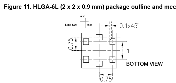

and finally the mech drawing shows another bottom side view which contradicts the figure 2 drawing..
whats correct?

actually I see that the mech drawing is actually rotated so it matches the figure 2 drawing but the tops side pin 1 mark still seems incorrect.

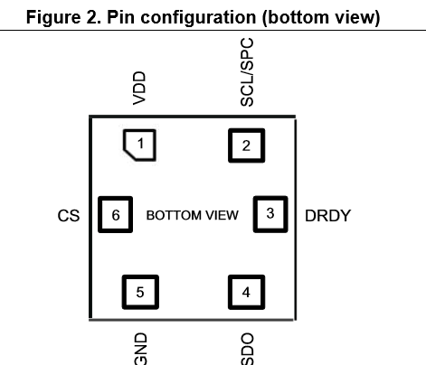

All three picture are correct.
I have rotated the picture with pinout by 90 degrees so it should clear now.
2018-01-29 6:37 AM
Just to confirm this is the bottom view, for making a pcb model I would need to flip it along the vertical access so that the pin 1 is in the upper left corner?

Yes, you are right.
