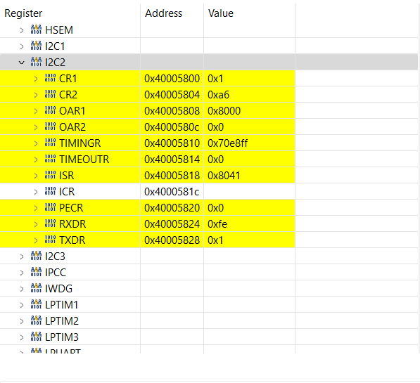

When I put my system on debug mode, following was the status of I2C registers. It shows me that BIT 15, i.e. BUSY is set in ISR. I have attached the screenshot.
