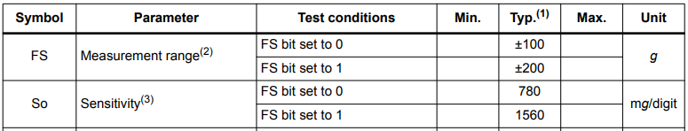

The output of the H3LIS200DLTR, for all ST accelerometers and sensors in general, is in digit, or LSB, referring to a Full Scale.
For the LSB to g conversion, you have to multiply the 8-bit output for the sensitivity that you can find on the device datasheet:
For the conversion formula, you can refer to the C examples on Github --> h3lis100dl_reg.c
float_t h3lis100dl_from_fs100g_to_mg(int8_t lsb)
return ((float_t)lsb / 256.0f) * 780.0f;
