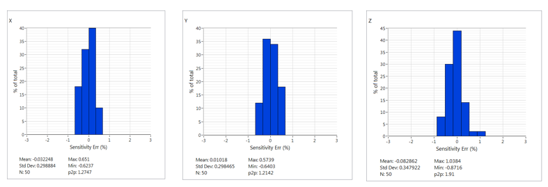

This concept is fairly related to the Sensitivity error (in acceleration). I can share you this value for the FS ±2g case.
Please let me know if it can be of some help.
