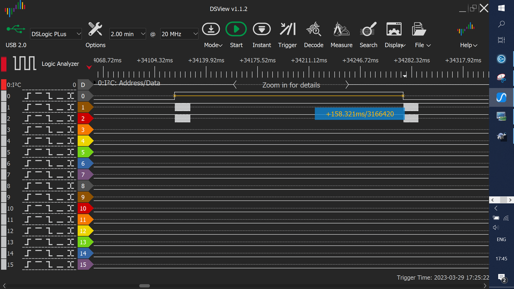

Expected:
Periodic interrupt from FIFO must happen every 160ms. But I am getting FIFO interrupt at ~158.4ms.
Could you please explain the cause of this time drift and how to fix it?

Looking at the data, a FIFO interrupt at 158.4 corresponds to measure an ODR of about 99Hz.
We measure the ODR accuracy only on characterization data and so we can't guarantee min-max values in production but measuring 99Hz instead of 100Hz is acceptable according to our data.

Hi @HHP.1 ,
A drift over time is not expected.
I can't give you detailed information because ODR Accuracy is not a tested parameter in production but according to characterization tests on a limited samples of data you can consider approximately up to 10%.
