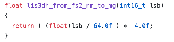

On the other hand, I would like to know why in the LIS3DH project configuration and data reading in GitHub (drivers), for example to calculate the value read with 2g FS in Normal mode you do the following operation:
I mean, I don't understand why you divide by 64 and multiply by 4. Wouldn't that be multiplying by 4000 and dividing by 65536?
Thanks in advance.
Regards
2020-05-18 7:57 AM
Hi @EEstr.1 , this formula is a direct consequence of the info reported in the datasheet:
So, to get the physical units from the LSB you have to undergo the following operations (e.g. for the X-axis data):
Regards
