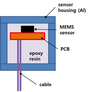

Or it might be wrong the way that I made the module. I put sensor PCB inside aluminum housing and filled epoxy resin (Araldite).

I saw you already tried with X-ray scanning (no issue with the aluminum housing?), so you might share these picture, so that we can submit them to our experts and expect a comment from them.
My question is: which kind of failure are you experiencing, exactly? For example, you might have experienced just a loss in SPI communication, or an overcurrent, or something else. Consider that the IIS3DWB module is composed by two parts inside the package: the MEMS (i.e. the mechanical structure) and the ASIC (i.e. the IC for the data acquisition). If the MEMS were damaged, the SPI communication should be there as well, while for a missing SPI the issue could be related to the chain cable - soldering - wire bonding between the chip and the substrate.
