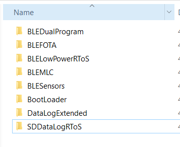

Hi @Snara.2 ,
if you want to use the BLE communication, you have to use the "BLE" examples. The SDDataLogRToS example is for storing data in the SDD card.
-Eleon

Thanks for sharing the information. It works well. If I need to know the technical design parameters. How shall I find the infromations? For instance :- In SD Datalog RTOS - What is the RTOS Timer event configured, Crystal configuration, DFSDM Filter configuration with more details why this has been choosen and SD Card interface. Whether the MX file available.
If I need to create a new project and add the code what would be the detail procedure to integrate witt the existing project which I am working (Which has all sensors available in SEnsortile.Box + BT).
