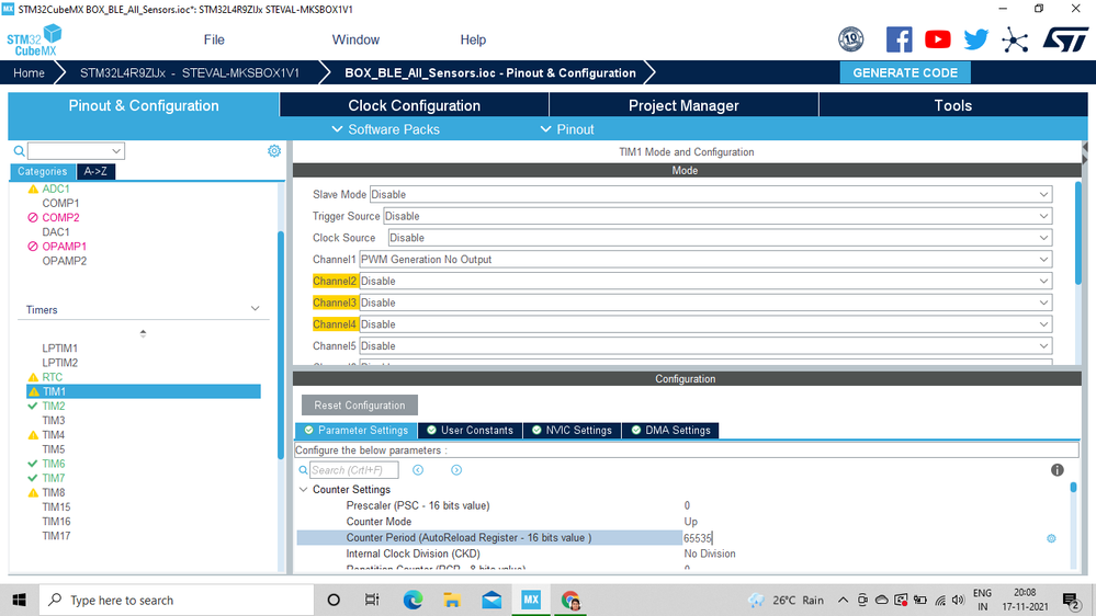

hi @Eleon BORLINI I have tried that please let m eknow how shall I configure cube MX

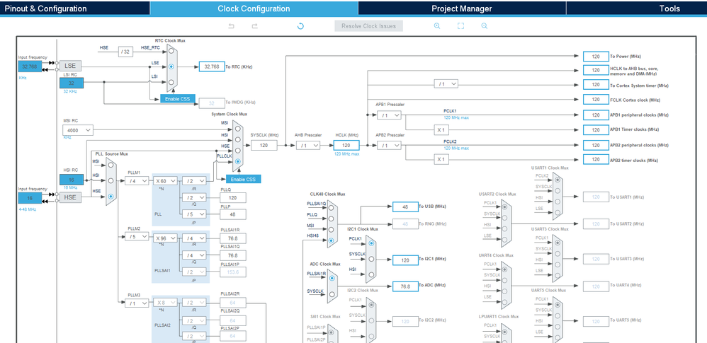

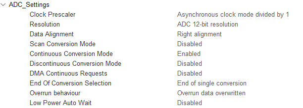

Hi @Snara.2 ,
I believe you should start with the predefined peripherals configuration in CubeMX for the SensorTile.box. In particular:
The default configuration of ADC1 is without DMA. This ADC is dedicated to the analog microphone acquisition.
You can find the default clock tree configuration in the proper tab. The master clock is 120MHz. I would use this configuration.
