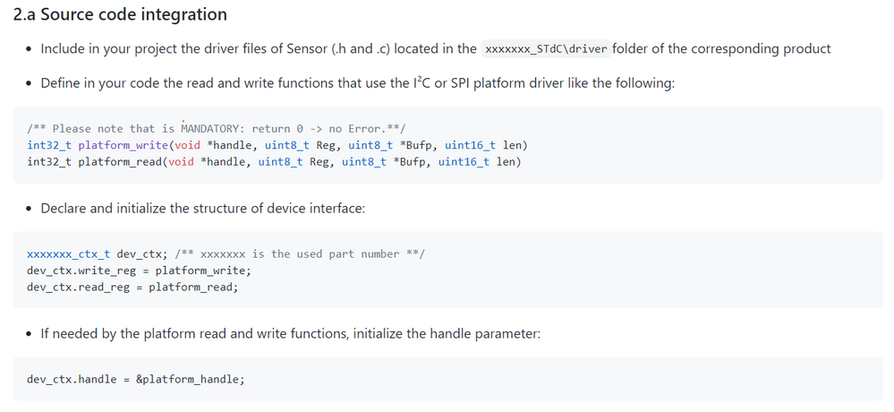

Hi @PRAMU.1​ ,
In order to integrate the, you can refer to the dedicated section in the readme file of Github homepage, at the paragraph:
0693W00000Bd5pGQAR.pngDid you already try this procedure?
-Eleon
