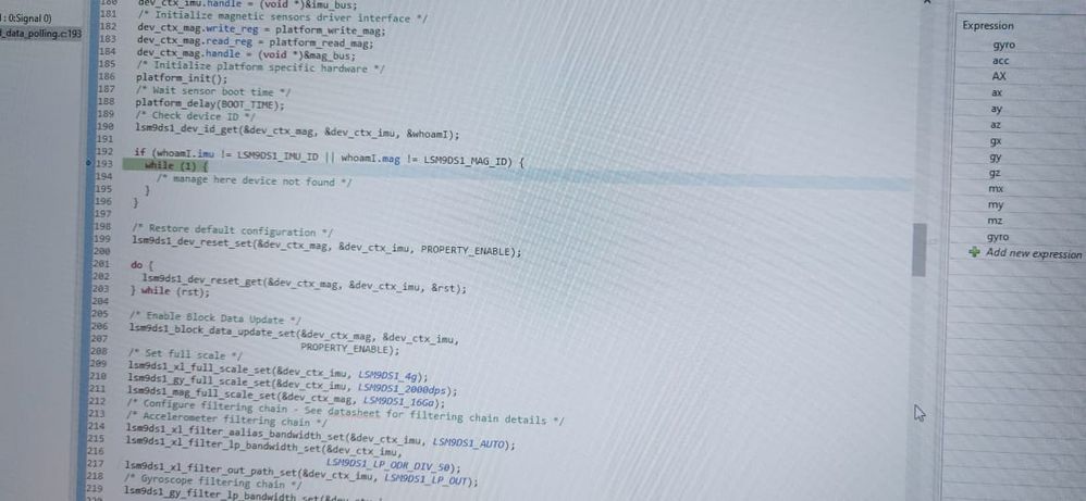

I am interfacing this lsm9ds1 MEMS sensor with the STM32F429zit6 nucleo board. LSM9DS1 IS NOT Responding I am using ST lsm9ds1 drivers on github using data polling code sensor is not responding, anyone tell me where the problem occures?

PRAMU.11
Associate II
PRAMU.11
Associate II
continuesly looping never get out of the loop.

how can i configure platform write and read in application code whre we are included that functions.
PRAMU.11
Associate II
im not mention platform write and read in main.c is this mention or not?
PRAMU.11
Associate II
/** Please note that is MANDATORY: return 0 -> no Error.**/
int32_t platform_write(void *handle, uint8_t Reg, uint8_t *Bufp, uint16_t len)
int32_t platform_read(void *handle, uint8_t Reg, uint8_t *Bufp, uint16_t len)
where can i write these functions
it returns always 0x00 only
