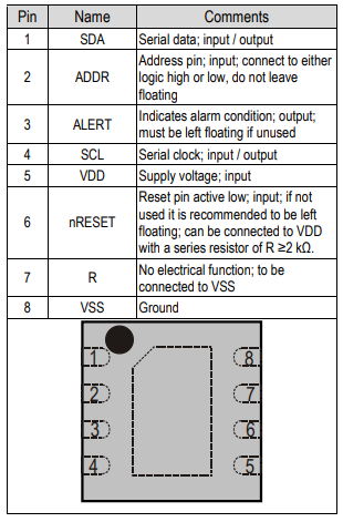

First of all, please check sensor pins : (SCL / SDA)
  • The communication must be with I2C protocol .

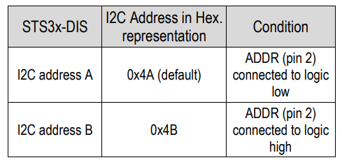

  • Check the I2C address for the sensor :
0693W00000Y9DwWQAV.pngFinally, open STM32CubeMx and start the configuration. :D
  • Then Look at the max frequency of the I2C communication : "The clock frequency can be freely chosen between 0 to 1000 kHz"
  1. Communication with frequencies up to 400 kHz must meet the I2C Fast Mode.
  2. Communication up to 1 MHz are supported (Fast Mode Plus)
