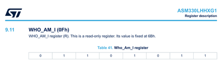

Why should it be 0x6?

Hi @arifkhan ,
The correct whoami, as reported also by @TDK , is 6Bh.

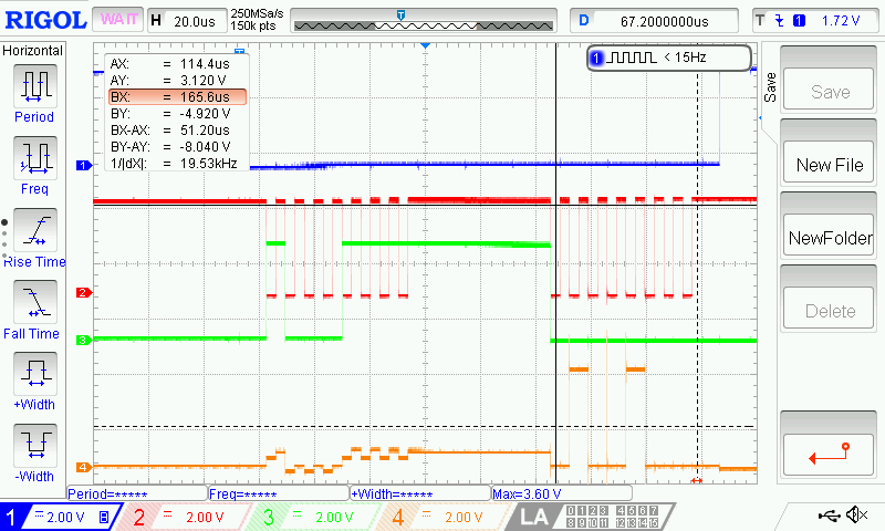

Yes, i have the scope connected to the 4 spi signals, I see 0x8F go out on the MOSI and I see 0x48 on the MISO wire every time. I put a 10k pullup on the CS wire and also a 10K pulldown on the INT1 signal.

Please show your scope trace.
Use the scope's screen capture if possible - it will give much better results than trying to photograph the screen!
Are you sure you have the correct SPI Mode?
Please post your schematic and show a minimum but complete code example which demonstrates the problem.

ch1- csn,
ch2 = spi clk,
ch3 = mosi,
ch4 = miso.
SPI cycle read of WHOAMI register spiAddr = 0x8F, spiData = 0x48 (should be 0x6B).
spi mode 3 i.e. clk polarity high, clock 2nd edge.

Something is clearly very wrong with your MISO:
@arifkhan wrote:
Do you have a good ground connection?
