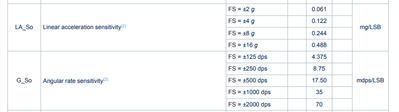

Data from the output registers are in LSB, if you want to convert them to g you need to multiply the LSB values by the sensitivity corresponding to your FS:
