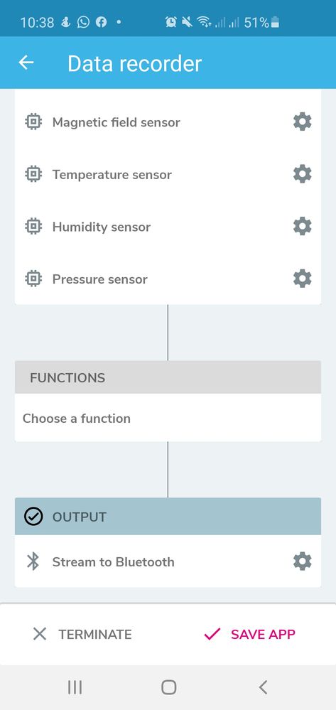

Hi John, the e-mail function works when the data are transmitted via BLE (example apps with the Bluetooth icon), and not directly stored on SD card (example apps with the SD icon, like the "Data recorder" one). In Expert view, you can create an app identical to Data recorder but with the "Stream to Bluetooth" output, as shown in the picture below. If you start the log in this configuration and then you stop it, you will receive the popup with the "send email request". Regards
