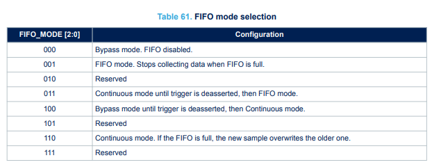

Hi @ASoni.2​ , back to this topic after long time... Your question is that, when you switch from"Stream-to-FIFO" to "Stream" mode, you cannot get no more data after the tap interrupt, right? Let's consider the device working conditions listed here below (AN5130 p.78):
I believe you should esc the "Continuous to FIFO" mode, enter the Bypass mode (000b) and then switching to the Bypass-to-continuous mode (100b), which should be triggered by the interrupt and starting with the filling of buffer B.
Regards

Hi @Eleon BORLINI​  Yes, I am fine with this query now. I have configured the sensor as stated in your answer.
