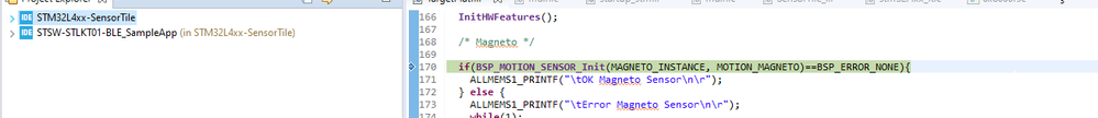

 /* Magneto */
// if(BSP_MOTION_SENSOR_Init(MAGNETO_INSTANCE, MOTION_MAGNETO)==BSP_ERROR_NONE){
//  ALLMEMS1_PRINTF("\tOK Magneto Sensor\n\r");
// } else {
//  ALLMEMS1_PRINTF("\tError Magneto Sensor\n\r");
//  while(1);
commenting the above mag section out and it functions fine...

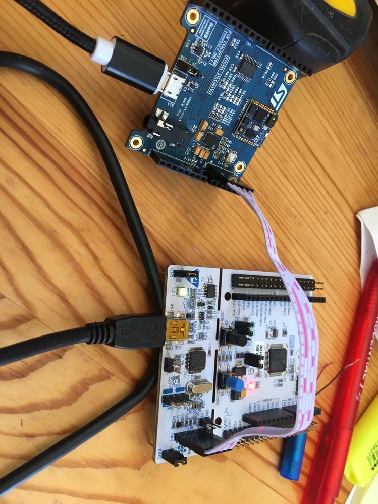

0693W000000WS8bQAG.png0693W000000WS8MQAW.jpgso rather confusingly it was not actually my home soldering, the newly purchased senortile also not has this problem on the stlcx01v1 cradle, having changed nothing on the firmware, this is starting to worry me as ive spent alot of time creating a custom board to run this firmware on.. STM32L4xx- sensortile firmware works on the initial debug but then changing nothing after a few times the above stopping point occurs, have you seen this error before?
