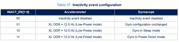

I'm a bit confused with your reply. You mentioned that "Unfortunately yes, the gyro ON is needed for the Activity/Inactivity pattern recognition.". If the gyro is required for Activity/Inactivity, then why does the INACT_EN[1:0] bits provide an option to power down the Gyro? Is the gyro required for detecting the Activity portion of the interrupt, Inactivity portion or does it need to be turned on for the duration that the Activity/Inactivity interrupt is used?

regarding your first question, the gyro part of the sensor is involved in the Activity to Inactivity pattern detection, and then can be put into sleep mode.
Regarding your second question, the Wake up interrupt is basically the "dual" action of the Activity/Inactivity interrupt: the device is inactive (except from the accelerometer) and configuring the wake up settings (enabling, threshold, duration, etc...) it can be recovered into normal mode.
