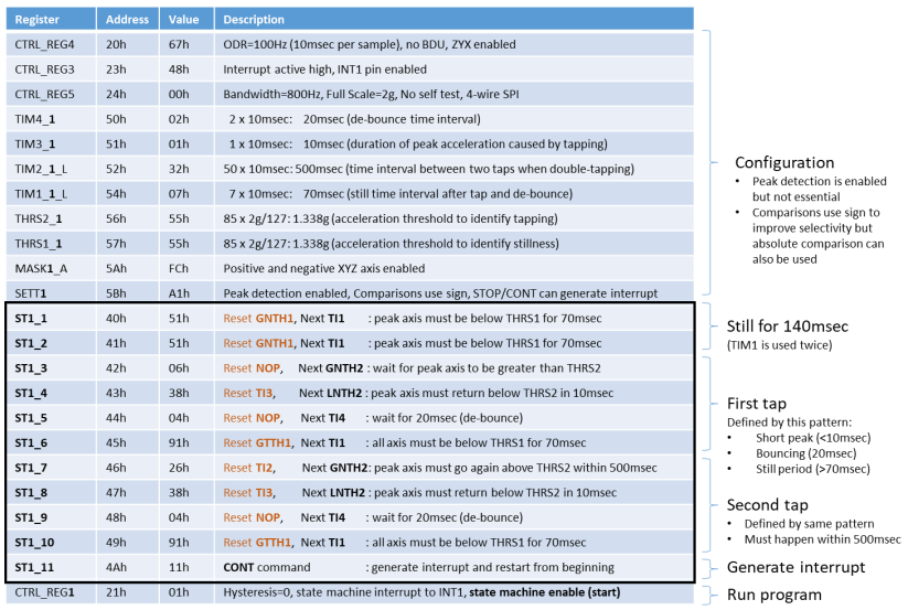

By the way, you can for example refer to the double-tap recognition in the DT0077, p.3: in this example, CTRL_REG3 is written after CTRL_REG4 and CTRL_REG1 is written at the end of the configuration.

I tried writing the registers following this pattern, register 4, 3, 5 then the threshold and mask and sett registers. in that case only the 3 control registers were written successfully. trying to write ST1 values and register 1 at the end didn't solve my problem. I am still unable to write register 1 and now with this pattern, threshold, mask and sett registers
