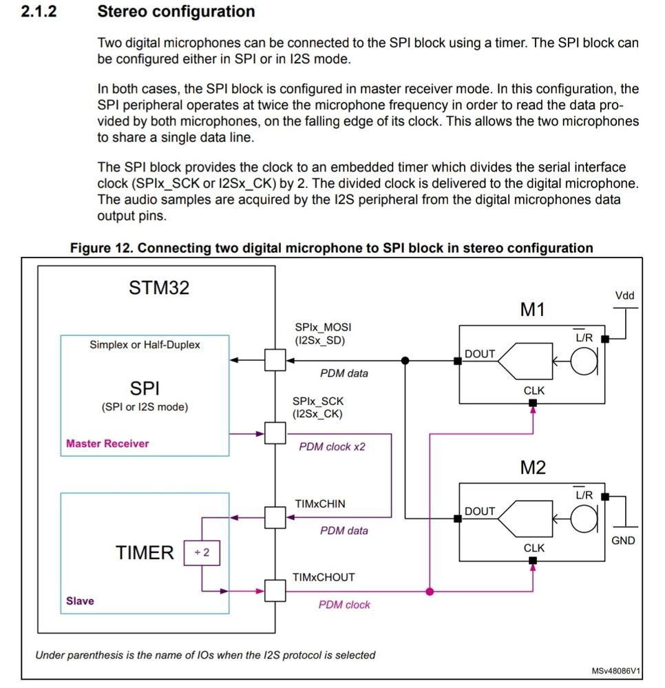

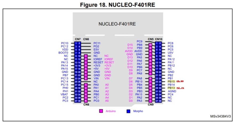

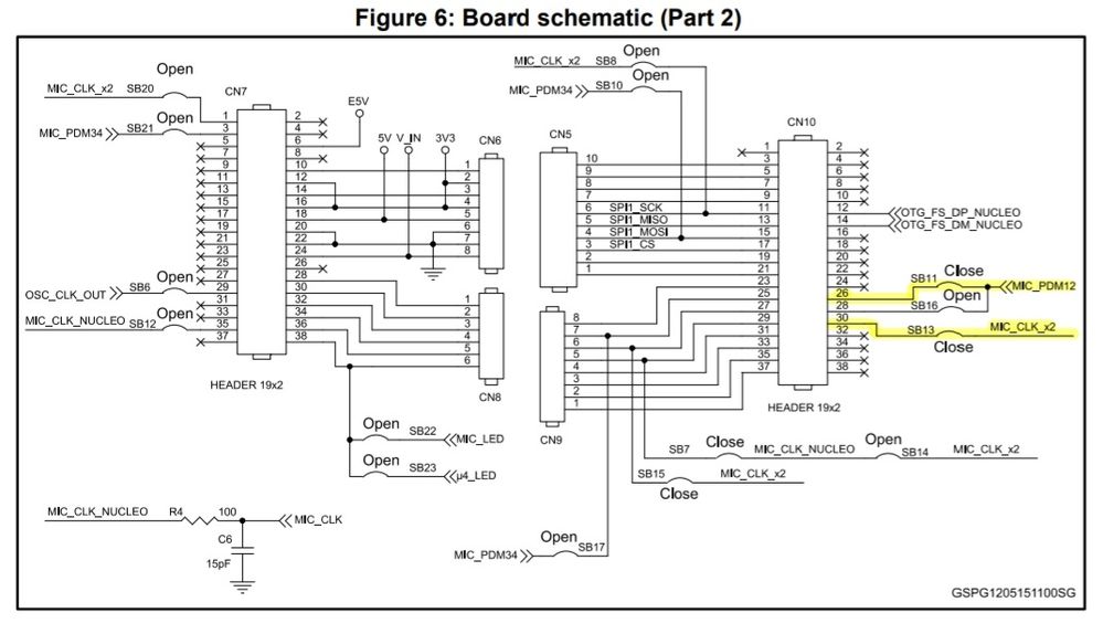

I read all the documentation for tthe expansion but nothing is working. In this moment watching the figure below I set using I2S2 the pin PB15 (I2S2_SD) and the pin PB13 (I2S2_CK). I add DMA in circular mode and set the frequency to 96kHz. The communication was set in half duplex in master reception mode. This pins were choose after watching the schematic of CCA02M2.
Here the schematics of NUCLEO and expansion.
All the information used were taken from a STM pdf here is a screenshot
After all the configuration I used this function the start the reception mode:
HAL_I2S_RECEIVE_DMA()And the relative callback to check which data were read by the microphone. The problem is that the data read are always 0. Another problem is that I don't understand why the MOSI pin is used to read the data in the STM pdf.
