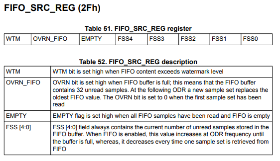

Eleon BORLINI
Hi @PD_learner​ ,
I'm wondering whether you might never enter in the condition:
if( watermark_val == 0x8B)
The meaning of that register is the following one:
0693W000006ENABQA4.pngYou may limit the condition of the loop to the first bit value of the above register.
You can in any case take inspiration from this code on Github designed for a product similar to the LIS2DH12 (with the "12" in the end, right?), in its register map --> lis3dh_multi_read_fifo.c
