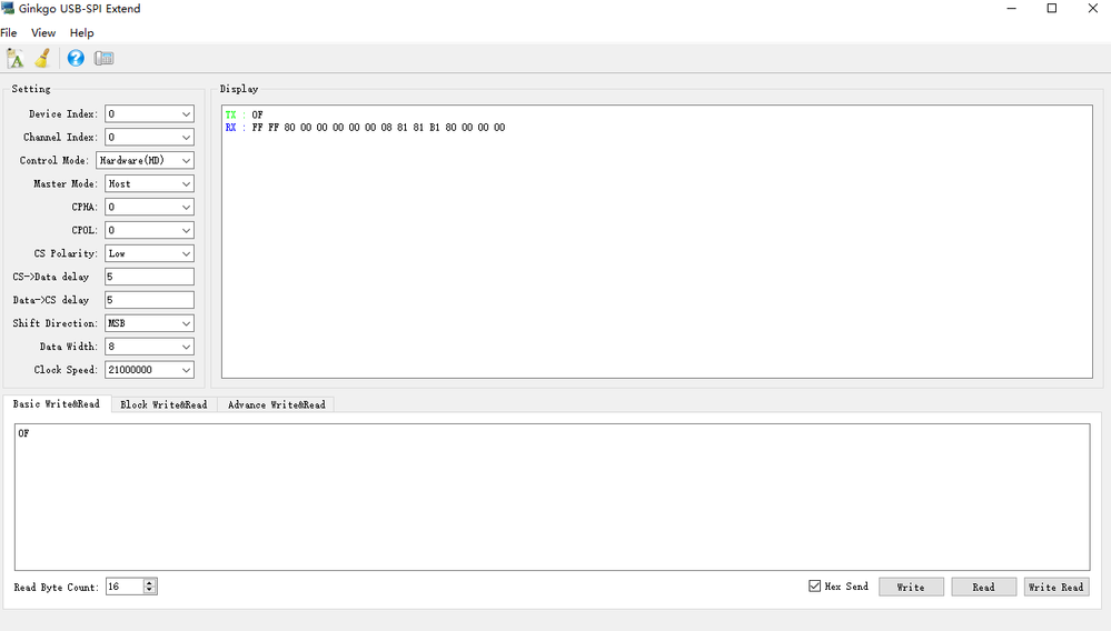

for the LIS2DTW12, I have use SPI communication, How can I get the LIS2DTW12 ID, do we need send which is command? Please tell me,thanks

_legacyfs_online_stmicro_images_0693W00000bi96xQAA.png the ID is not OK

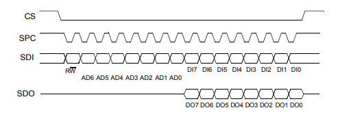

Ciao @LUKE​ ,
How are you implementing the read protocol of SPI?
In order to read a register in SPI mode you need to follow this sequence:
_legacyfs_online_stmicro_images_0693W00000biJbqQAE.pngIf my reply answered your question, please click on Select as Best at the bottom of this post. This will help other users with the same issue to find the answer faster!

when I use I2C interface , send :address0x19,subaddr,0x0f ,get the read value: 0x44, it is ok for the result. but use the SPI, I send ,read the value:FF FF 80 00 00 00 00 00 81 B1 80 00 00
