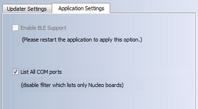

but i'm not able to connect the sensor tile with bluetooth on unicleo gui. Despite all my work, update and any thing i can do, unicleo dont want to detect the sensor. I'm try on windows 8.1, the sensor is well appaired, but buton to activate bluetooth is still not accessible.

The BLE support in Unicleo-GUI is not available for Windows 8.1, you would need to use Windows 10.
